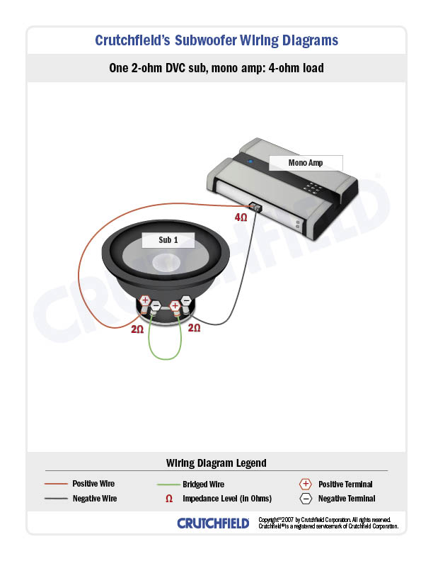

SS Teacher 177 Posted March 8, 2017 10 minutes ago, Bresch said: Unfortunately the Icon only comes in 1ohm and 2ohm dual voice coils. This would require me to wire up my Alpine MRX110 amp at 1ohm either way and the amp's mono block circuitry isn't the best for a 1 ohm load. It only has an output of 800 watts RMS at that load and I'm unsure how quickly it would heat up, but I assume too quickly. I bought an XCON in dual 1 voice coils so I could wire it to 2 ohm and take it easy on my electrical. 0 Share this post Link to post Share on other sites
S.DeYoung 968 Posted March 8, 2017 34 minutes ago, Bresch said: Unfortunately the Icon only comes in 1ohm and 2ohm dual voice coils. This would require me to wire up my Alpine MRX110 amp at 1ohm either way and the amp's mono block circuitry isn't the best for a 1 ohm load. It only has an output of 800 watts RMS at that load and I'm unsure how quickly it would heat up, but I assume too quickly. Dual one ohm can be wired into .5 ohm or 2 ohm. Dual two ohm can be wired into 1 ohm or 4 ohm. 0 Share this post Link to post Share on other sites
Bresch 0 Posted March 8, 2017 (edited) 31 minutes ago, SS Teacher said: I bought an XCON in dual 1 voice coils so I could wire it to 2 ohm and take it easy on my electrical. Oh, I assumed too much! How do you wire it up at 2 ohms? Is it a standard wiring schematic like the following: Credit to Crutchfield.com Edited March 8, 2017 by Bresch 0 Share this post Link to post Share on other sites
SS Teacher 177 Posted March 8, 2017 Crutchfield and Sonic Electronix have decent how to guides, but... www.bcae1.com is a GREAT website with tons of basic information, check it out. 0 Share this post Link to post Share on other sites
